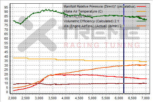

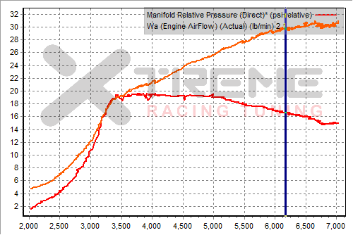

v0 stats - VF30 Turbo
Posted: Tue Dec 08, 2015 6:29 am
v0 4th Gear Dyno SAE - boost vs wa.png (14.31 KiB) Viewed 20341 times

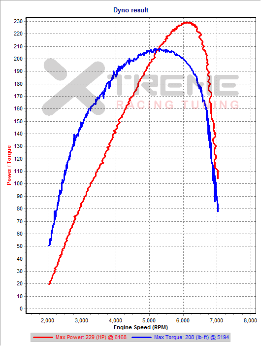

v0 4th Gear Dyno SAE.png (22.36 KiB) Viewed 20341 times

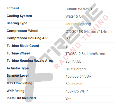

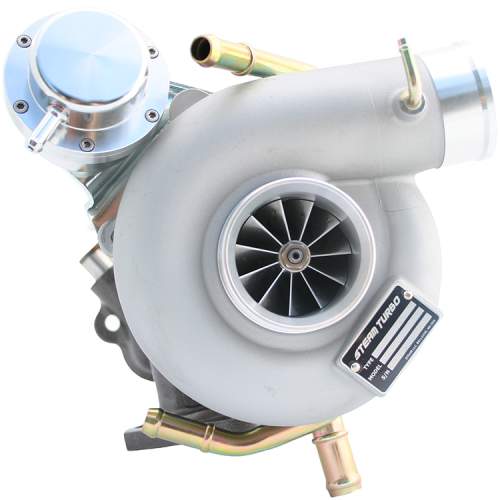

Steam STX 71 for Subaru WRX/STI 8 cm²
Posted: Wed Dec 30, 2015 12:58 am
http://steamturbochargers.com/index.php ... i-8cm.html
STX Standard Features:
Billet compressors wheel: featuring Garrett GTX style areo 11-blade wheels custom made from billet 7075 aluminum.
Low inertia turbine wheel: Standard with 9-blade low inertia turbine wheels. These turbines weigh 1/3 less than standard wheels significantly increasing the responsiveness, low-end torque, and top-end power.
Thrust bearing: CHRA built to last with heavy duty thrust bearings for high boost & power applications.
Adjustable Actuator: Adjustable actuator springs are available in our accessories section.

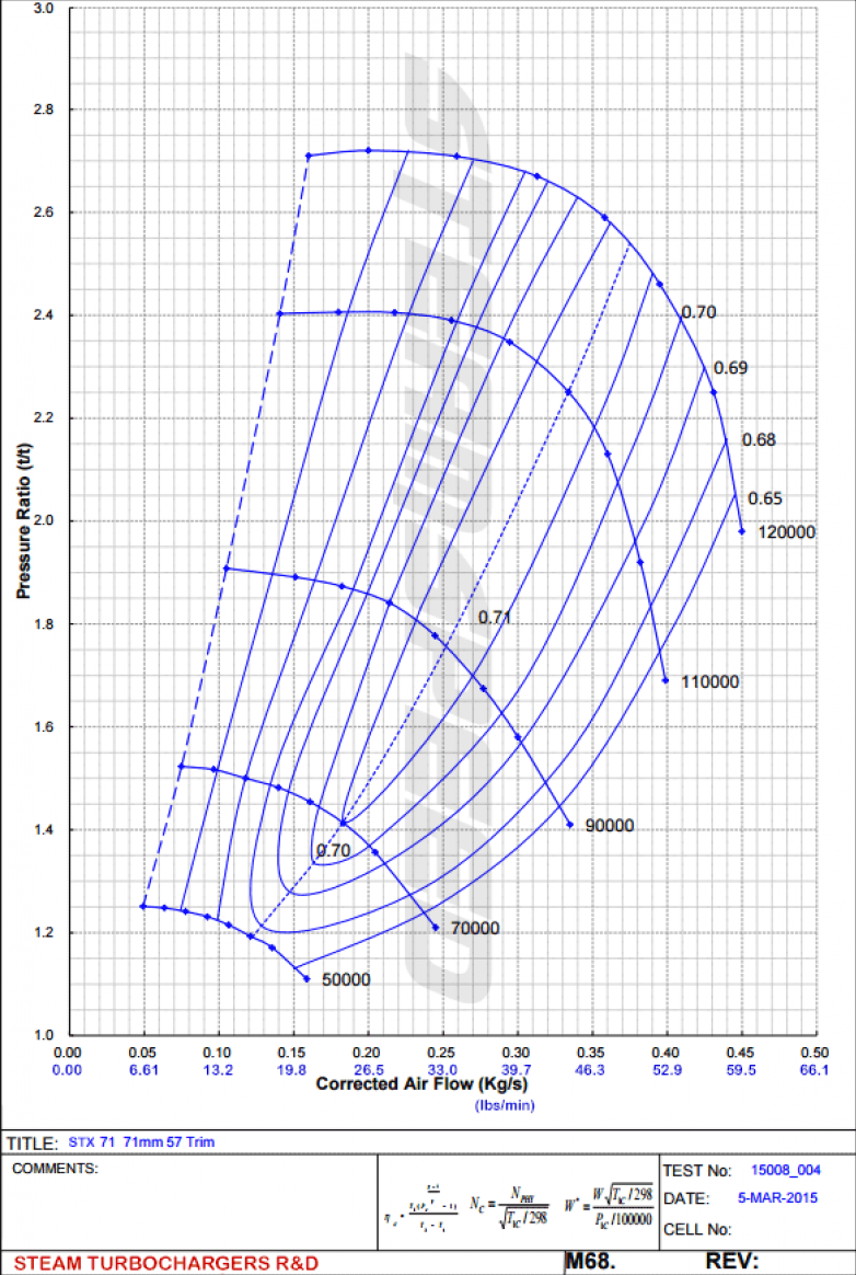

STX-71 Specs.png (25.46 KiB) Viewed 20322 times

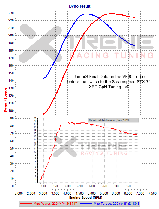

v9 Dyno - IHI VF30
Posted: Sat Jan 09, 2016 6:52 pm
I believe the stock turbo (IHI VF30) is not running efficiently, thereby providing the figures below. Having worked on a number of cars using the IHI VF30, they have netted around 270-290whp.
v9 3rd Gear Dynoa SAE sm=120.png (59.7 KiB) Viewed 20300 times
