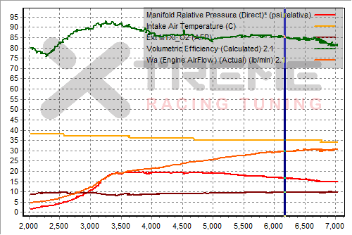

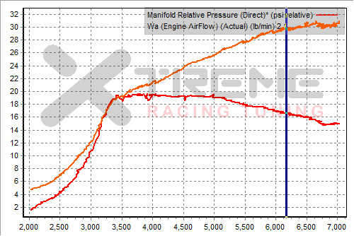

All dyno'es are based on vss
v0 stats - VF30 Turbo
v0 4th Gear Dyno SAE - boost vs wa.png (14.31 KiB) Viewed 20292 times
v0 4th Gear Dyno SAE - Stats.png (16.42 KiB) Viewed 20292 times
v0 4th Gear Dyno SAE.png (22.36 KiB) Viewed 20292 times

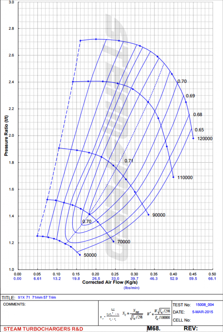

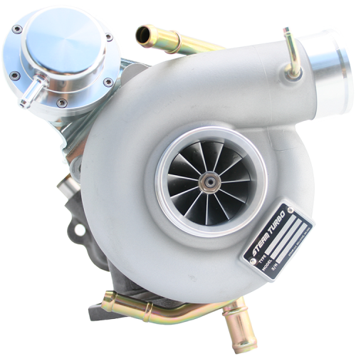

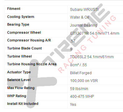

Steam STX 71 for Subaru WRX/STI 8 cm²
http://steamturbochargers.com/index.php ... i-8cm.html
STX Standard Features:
Billet compressors wheel: featuring Garrett GTX style areo 11-blade wheels custom made from billet 7075 aluminum.
Low inertia turbine wheel: Standard with 9-blade low inertia turbine wheels. These turbines weigh 1/3 less than standard wheels significantly increasing the responsiveness, low-end torque, and top-end power.
Thrust bearing: CHRA built to last with heavy duty thrust bearings for high boost & power applications.
Adjustable Actuator: Adjustable actuator springs are available in our accessories section.
STX-71 Specs.png (25.46 KiB) Viewed 20273 times

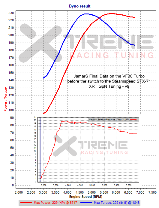

v9 Dyno - IHI VF30
I believe the stock turbo (IHI VF30) is not running efficiently, thereby providing the figures below. Having worked on a number of cars using the IHI VF30, they have netted around 270-290whp.
v9 3rd Gear Dynoa SAE sm=120.png (59.7 KiB) Viewed 20251 times
