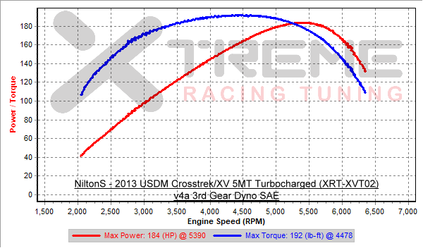

v4a 3rd Gear Dyno SAE
v4a 3rd Gear Dyno SAE.png (26.72 KiB) Viewed 11976 times

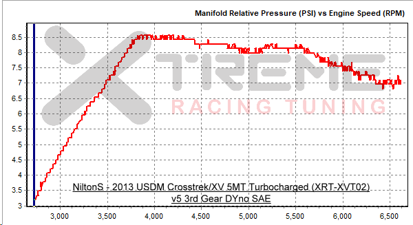

v5a 3rd Gear Dyno SAE Boost.png (27.1 KiB) Viewed 11921 times

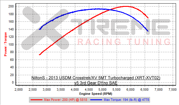

v5a 3rd Gear Dyno SAE Power.png (26.15 KiB) Viewed 11921 times

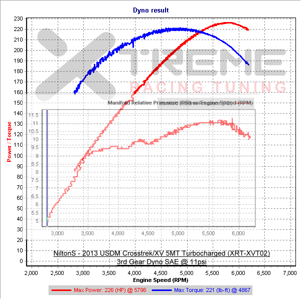

v6 3rd Gear Dyno SAE
v6 3rd Gear Dyno SAE.png (55.8 KiB) Viewed 10800 times
