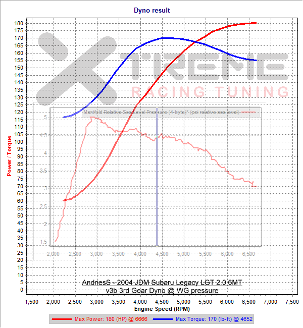

v3b 3rd Gear Dyno SAE
v3b 3rd Gear Dyno SAE.png (50.29 KiB) Viewed 14268 times

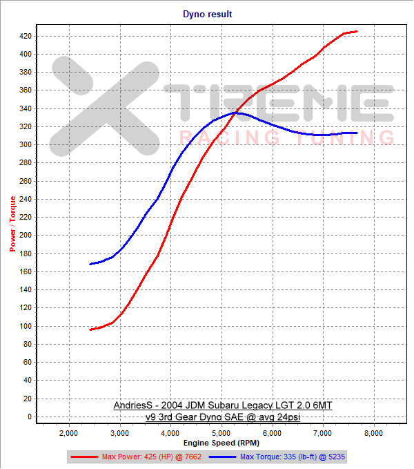

v9 3rd Gear Dyno SAE @ avg 24psi
v9 3rd Gear Dyno SAE @ 24psi.png (32.38 KiB) Viewed 14205 times

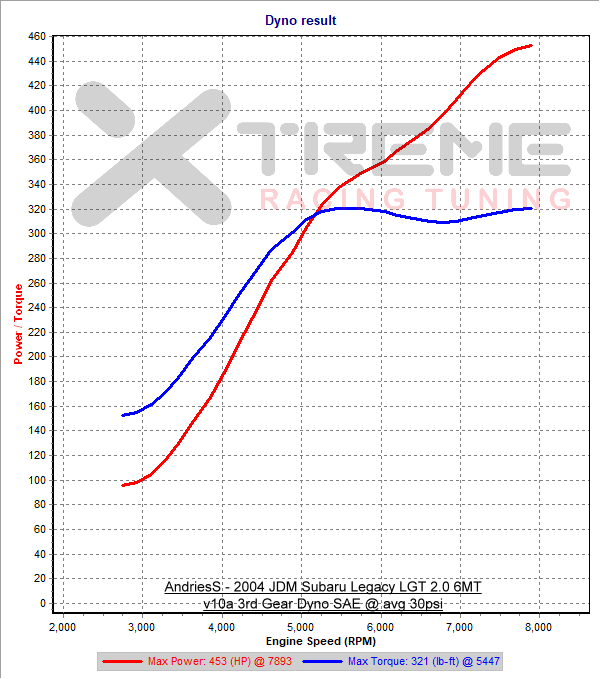

v10a 3rd Gear Dyno SAE @ avg 30psi
v10a 3rd Gear Dyno SAE @ avg 30psi.png (32.46 KiB) Viewed 14204 times
