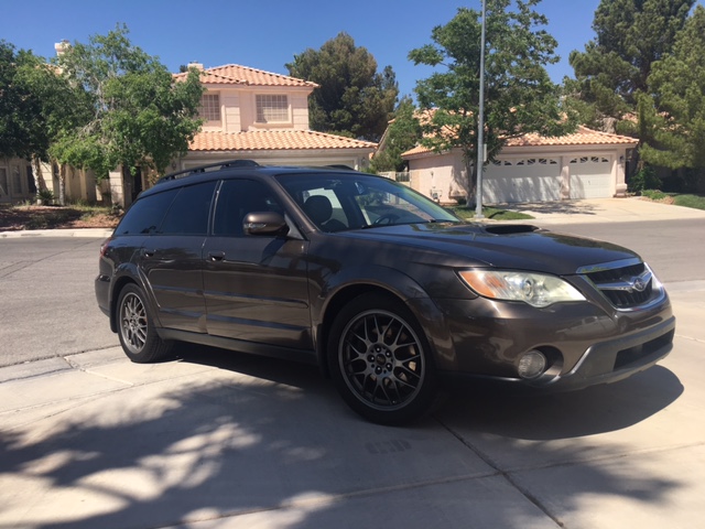

v0 - First Start-up
Post by KeithC »
V0 Start up was noticeably quieter from my own attempt.
Start up was crisp and clean and idles smooth a bit less smooth in gear but nothing to be upset about.
10%-25% throttle was very effective,feels like we're making more power with a lot less boost already.
Slight sputter at low throttle < 5% after idling in the driveway for 10 minutes but did not repeat itself. Currently the outside temp is 96 deg F.
IMG_1073 (1).JPG (127.04 KiB) Viewed 15272 times

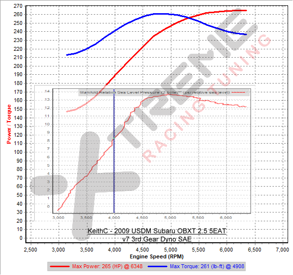

v7 3rd Gear Dyno SAE @ low boost
v7 3rd Gear Dyno SAE.png (65.61 KiB) Viewed 15185 times
