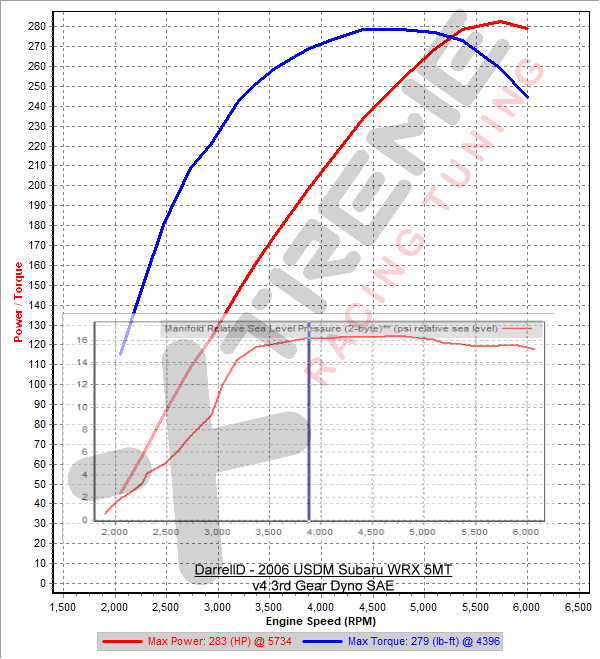

v4 3rd Gear Dyno SAE
v4 3rd Gear Dyno SAE.png (78.26 KiB) Viewed 10885 times

Due to the EJ255 VE roll off, GSC S1 cams been recommended:
https://www.power-division.com/billet-s ... -avcs.html
Another option is the Kelford R-199-B cams:
https://www.kelfordcams.com/global/cams ... t-set.html
