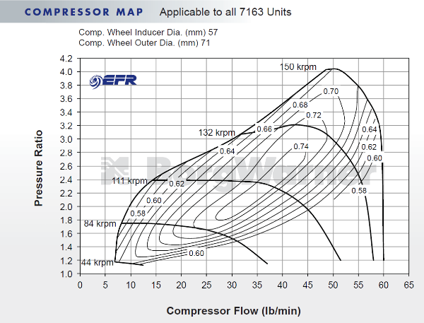

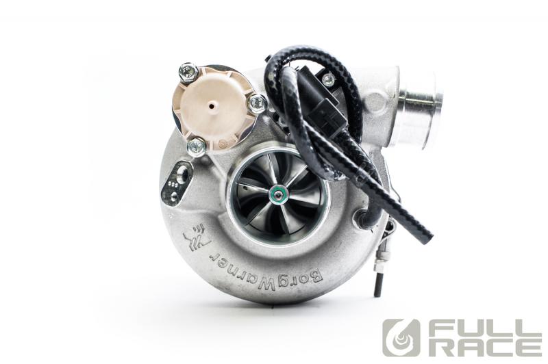

BW EFR7163 Turbo

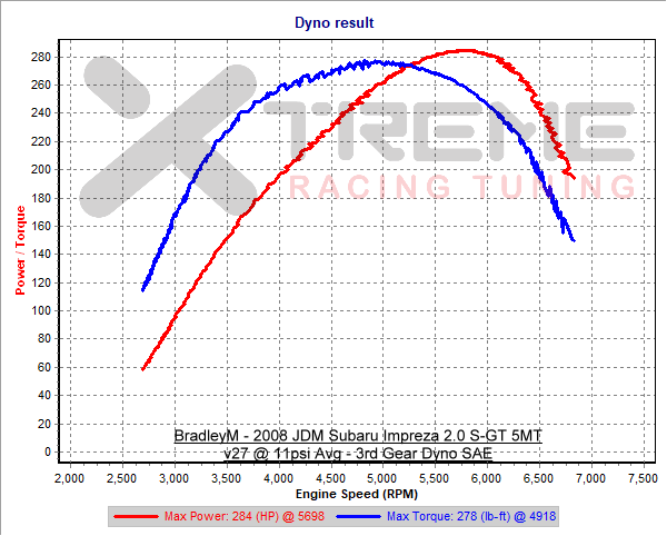

v27 3rd Gear Dyno SAE @ 11psi

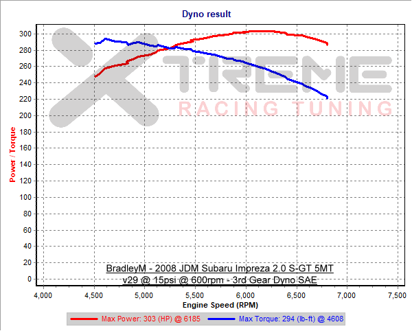

v29 15psi_6000rpm - 3rd Gear Dyno SAE
