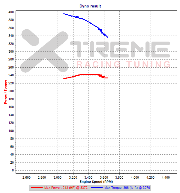

Installation of the 12psi Wastegate Actuator
v4 Partial 4th Gear Dyno SAE @ 23.5psi.png (21.89 KiB) Viewed 12754 times

Anyway, the tuning process with Ed makes me feel that we are the factory test driver fine tuning the car. It's not just doing 3rd gear pull, Ed will ask u to log under different driving condition as well and fine tune according to the logs and your driving experience revision by revision.

We are having flow issues over 230-240whp.
