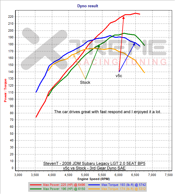

Re: StevenT - 2008 JDM Subaru Legacy LGT 2.0 5EAT BP5
The turbo is limiting the setup and needs replacing with one that can flow 350chp.
v5c vs Stock - 3rd Gear Dyno SAE.png (46.51 KiB) Viewed 8083 times
