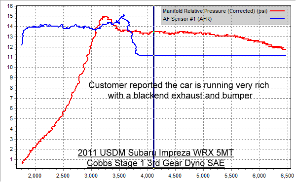

Stock 3rd Gear Dyno SAE
Posted: Sun Jul 16, 2017 5:08 pm
Cobbs Stock 3rd Gear boostvsAFR.png (29.89 KiB) Viewed 12286 times

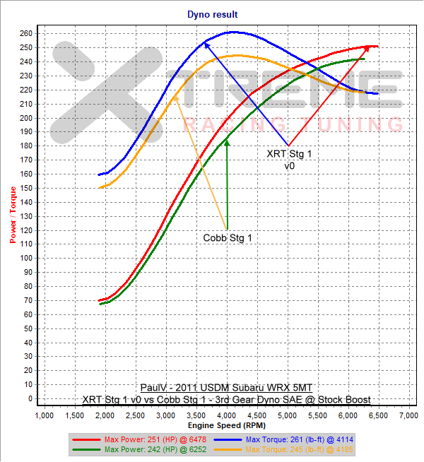

XRT v0 vs Cobbs Stg1 - 3rd Gear Dyno SAE
Posted: Sun Jul 16, 2017 7:13 pm
XRT v0 vs Cobbs Stg1 - 3rd Gear Dyno SAE @ Stock boost.png (44.83 KiB) Viewed 12136 times

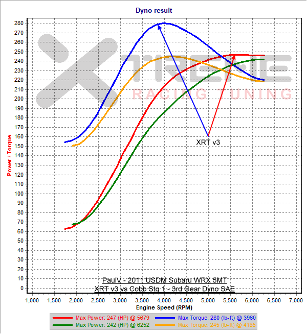

v3 3rd Gear Dyno SAE
Posted: Mon Oct 16, 2017 5:50 pm
v3 3rd Gear Dyno SAE.xml.png (38.19 KiB) Viewed 12135 times
Customer
Posted: Thu Oct 19, 2017 5:08 pm
I can definitely feel a difference in torque when compared to the off the shelf cobb tune but I need to upgrade the exhaust and downpipe to notice a big difference. Can't wait!
