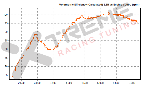

Stock Drag Data
Stock VE.png (11.22 KiB) Viewed 12398 times

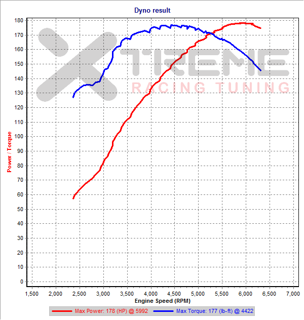

Stock 2nd Gear Dyno SAE vss.png (22.5 KiB) Viewed 12398 times

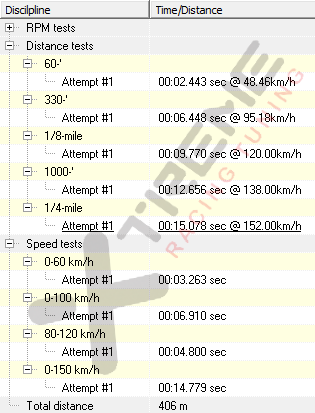

Stock Drag Pull #1.png (16.44 KiB) Viewed 12417 times

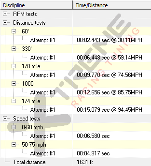

Stock Drag Pull #2.png (28.07 KiB) Viewed 12417 times

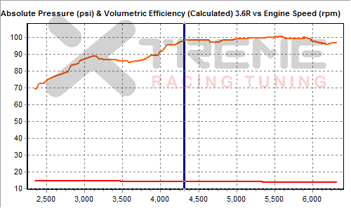

v2a 2nd gear Dyno VE
v2a 2nd Gear Dyno VE.png (30.3 KiB) Viewed 12337 times

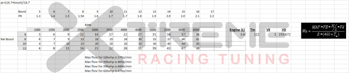

Preparations for Boost - Engine Flow
Engine Flow.png (36.27 KiB) Viewed 12335 times
