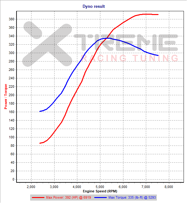

JasonW - 2004 JDM Impreza WRX STI 2.0L 6MT - GpN Tuning
2001+ Subaru STI
Owner: JasonW
Rom:CarBerry
Tyres: 235/45-17
Car Weight: 1477kg
Driver Weight: 73kg
Total Weight: 1550kg
Stock
Blitz SBC Boost COntroller
Tuned: XRT Group N Rally w/ MAF, AL, LC

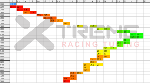

3rd Gear Pulls Stats #1.png (22.71 KiB) Viewed 23915 times

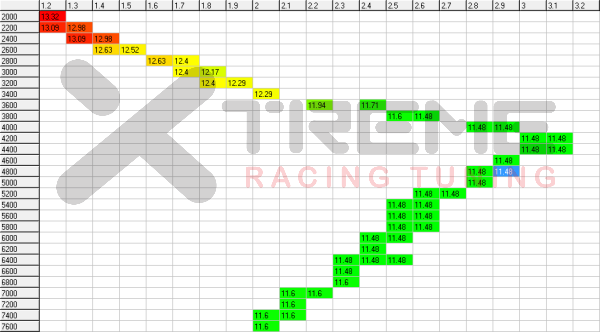

3rd Gear Pulls Stats #2.png (20.68 KiB) Viewed 23915 times

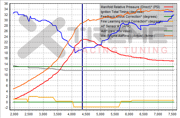

3rd Gear Pulls Stats #3.png (38.26 KiB) Viewed 23913 times

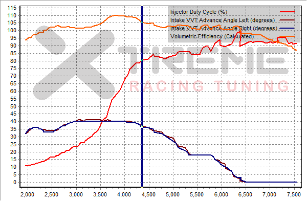

3rd Gear Pulls Stats #4.png (43.68 KiB) Viewed 23913 times

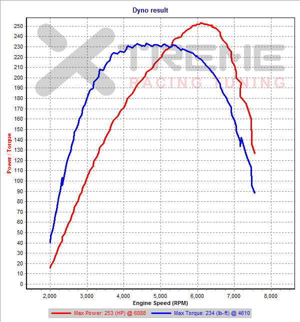

Stock 3rd Gear Dyno SAE.png (32.41 KiB) Viewed 23904 times

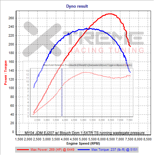

New Modifications
New Mods Application: Subaru WRX/STi JDM Twin Scroll Turbocharger
Horsepower: 470HP
Specs - http://www.xtremeracingtuning.com/forum ... ?f=8&t=450
  • Custom low friction low inertia ceramic ball bearing CHRA
  • Custom high flow low inertia 56.5mm turbine wheel
  • 71mm XT Compressor wheel
  • 47lbs per min
  • BPT Twin Scroll Turbine housing
v2 @ wastegate pressure
Still under wastegate pressure of 15psi by 2psi and way under normal operating boost of 19-20psi.
GpN2v2 4th Gear Dyno SAE.png (46.84 KiB) Viewed 23724 times

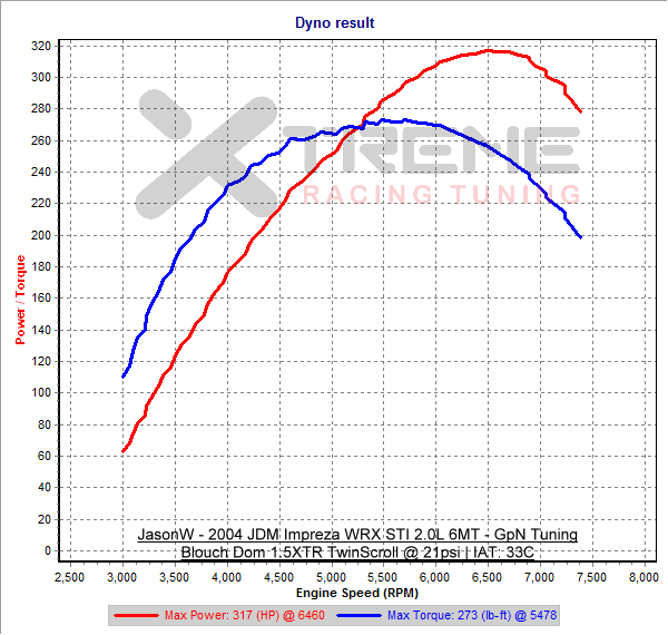

Update: 2017-07-09
A new Turboback system was installed and all flow issues been fix. Tuning has restarted and we are now reaching MAF limit and will blend to VE very soon.
Blouch Dom 1.5XTR TwinScroll @ 21psi | IAT-33C
BlouchDom15XTR-TS @ 21psi-IAT-33C.png (30.76 KiB) Viewed 23321 times
