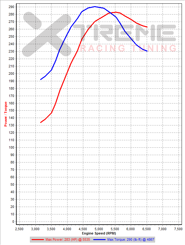

v10

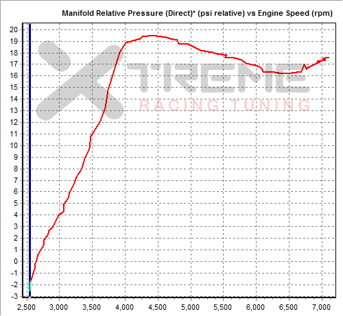

v9 Boost.png (17.41 KiB) Viewed 11947 times
v9 XRT-GpN 3rd Gear Dyno SAE sm=2 tm=150.png (33.1 KiB) Viewed 11945 times

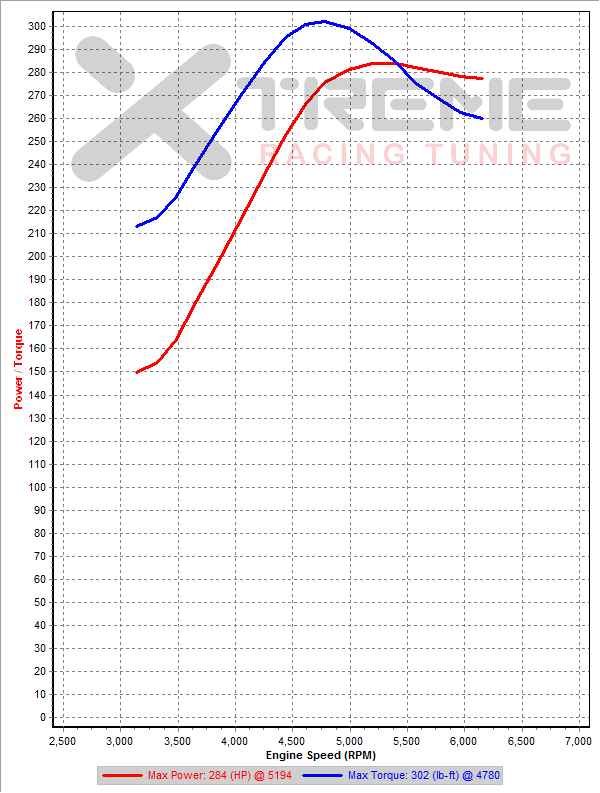

XRT-GpN-v18 - 3rd Gear Dyno SAE
XRT-GpN-v18 - 3rd Gear Dyno SAE sm=2 tm=120.png (27.25 KiB) Viewed 11923 times

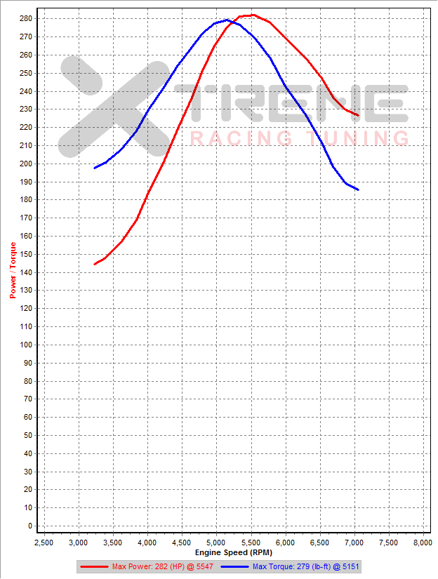

20% E85 +80% 98Octane + 2 degrees of ignition timing.
Car is having AVCS issues.
XRT-GpN-v19 - 3rd Gear Dyno SAE sm=2 tm=150.png (25.5 KiB) Viewed 11923 times
