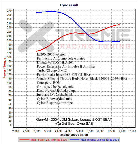

v7e 3rd Gear Dyno SAE.png (59.05 KiB) Viewed 12714 times
