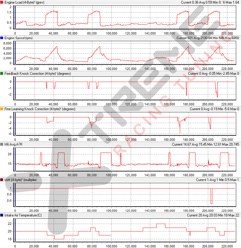

Stock Performance Data.png (89.08 KiB) Viewed 8348 times

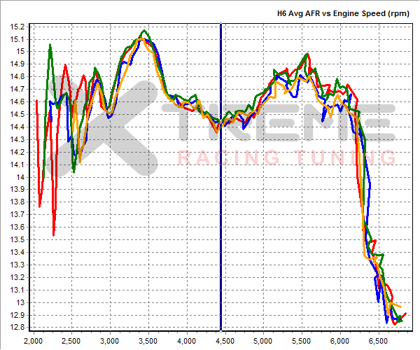

Stock Engine Stats.gif (103.23 KiB) Viewed 8348 times

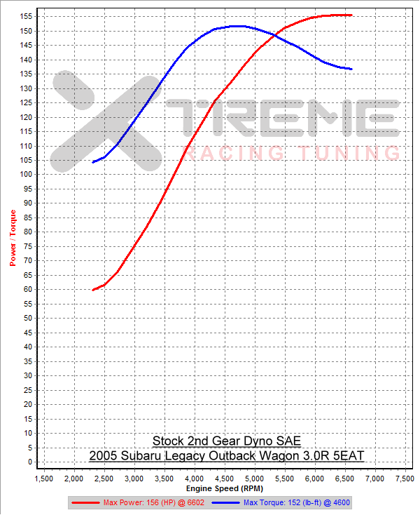

Stock 2nd Gear Dyno SAE sm=2 tm=200.png (34.56 KiB) Viewed 8313 times

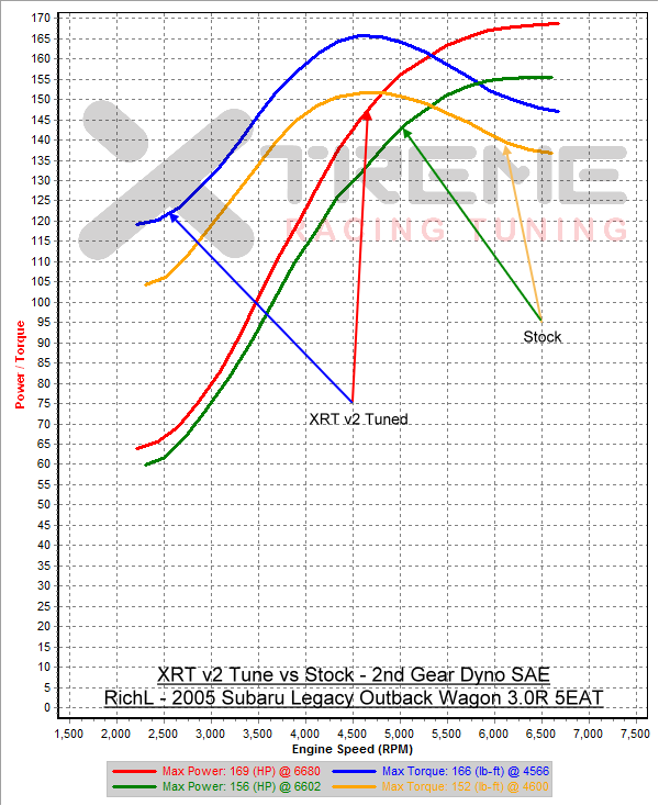

v2 Dyno stats
Posted: Thu Apr 10, 2014 11:23 pm
XRT v2 vs Stock - 2nd Gear Dyno SAE sm=2 tm=200.png (50.22 KiB) Viewed 8313 times
