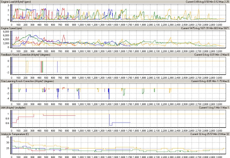

Stock Stats
Stock Stats.png (125.67 KiB) Viewed 12897 times

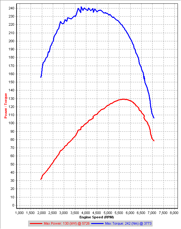

v0 2nd Gear Dyno IAT=46-38C
v0 2nd Gear Dyno IAT=46-38C.png (15.22 KiB) Viewed 12896 times
v1 2nd Gear
V1 is just AVCS Tuning w/ pinging reduction
v1 vs v0 - 2nd Gear Dyno.png (51.3 KiB) Viewed 12896 times
V1 is the blue line
v1 vs v0 - Minor AVCS Tuning.png (92.32 KiB) Viewed 12896 times
