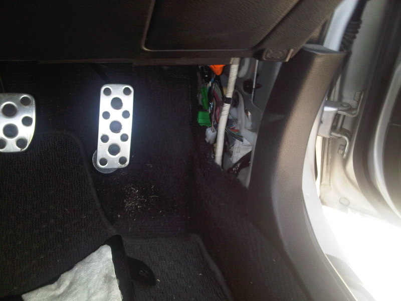

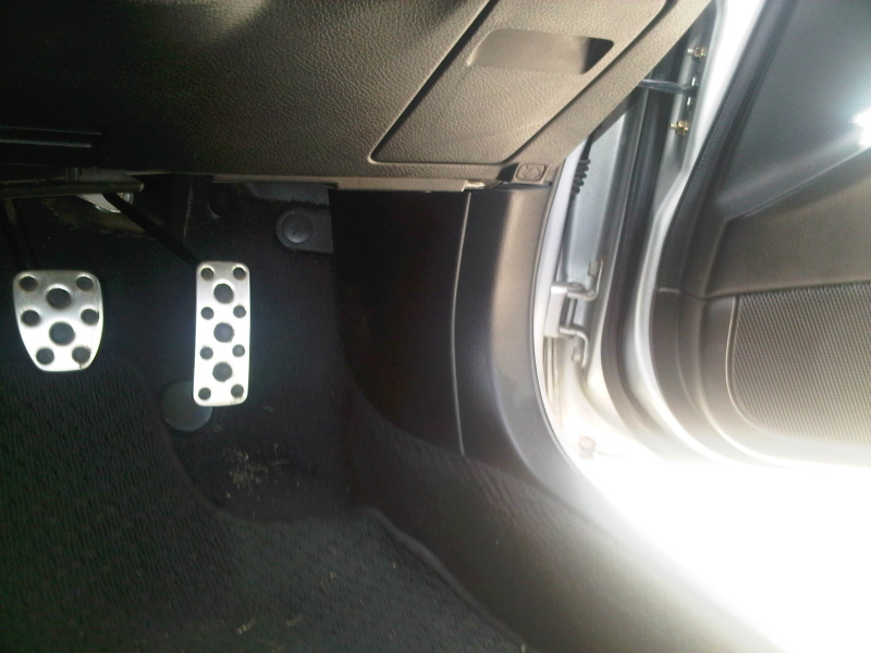

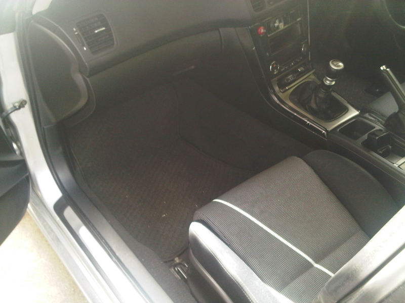

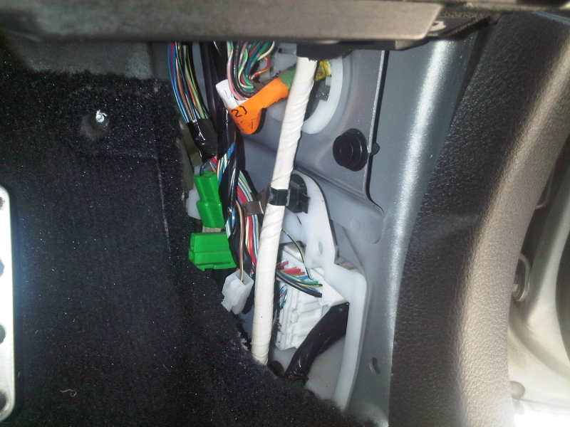

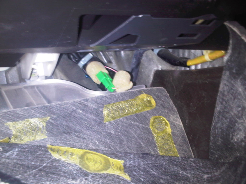

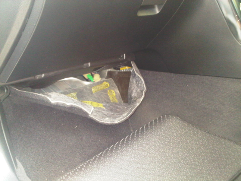

To read or flash the rom on the 2003+ Subaru Legacy, you will need to connect the follow pair of green connectors
Passenger Side - RHD Car
Driver Side - RHD Car
