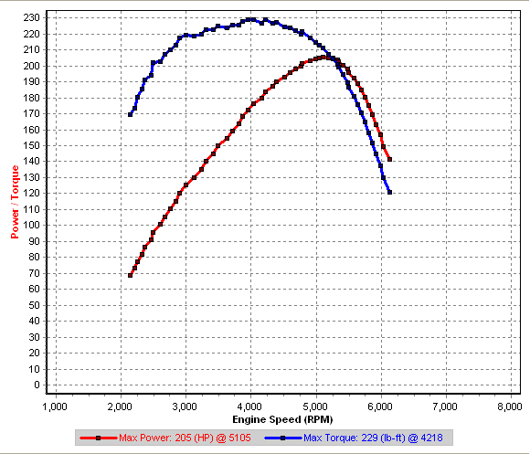

Alvin JDM WRX XRT Stage 1.5 Tuned
- Attachments

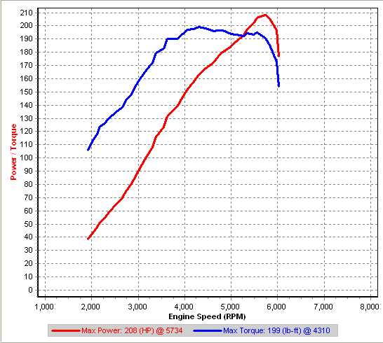

- Version 0 Rom Road Dyno.
No tuning was done. This rom is a fact finding rom - Start tuning road dyno.gif (9.94 KiB) Viewed 14495 times

Re: Alvin JDM WRX XRT Stage 1.5 Tuned

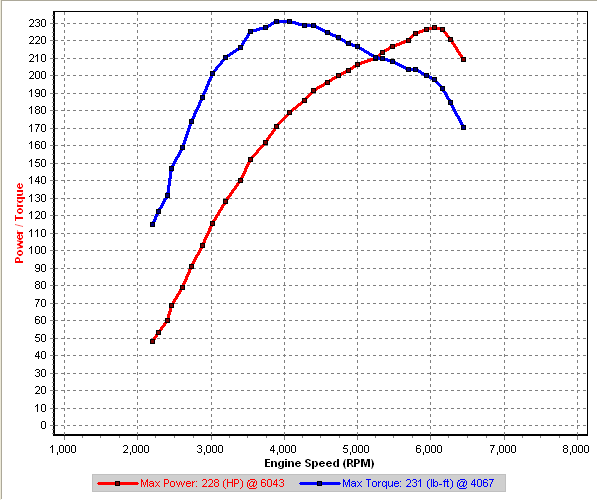

Version 7 Rom Road Dyno done at night
- Attachments
- Version 7 Rom Road Dyno at night
- 3rd Gear Dyno.png (12.42 KiB) Viewed 14492 times

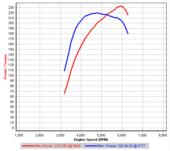

Version 11 Rom Day-Time Road Dyno
The dyno was not perform at 100% throttle throughout the range.
More tuning was done with this rom. A little more fuel and AVCS
- Attachments
- Version 11 Rom Day-Time Road Dyno.
Was not attained at 100% Throttle. - v1-11 Semi road dyno.png (10.03 KiB) Viewed 14489 times

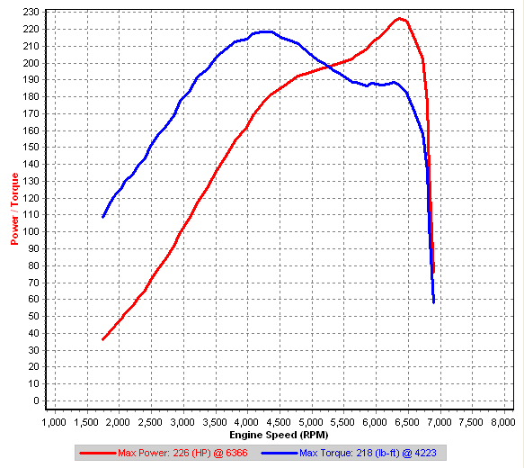

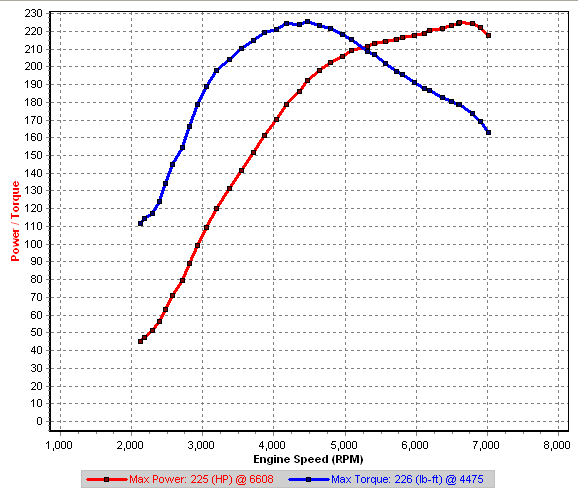

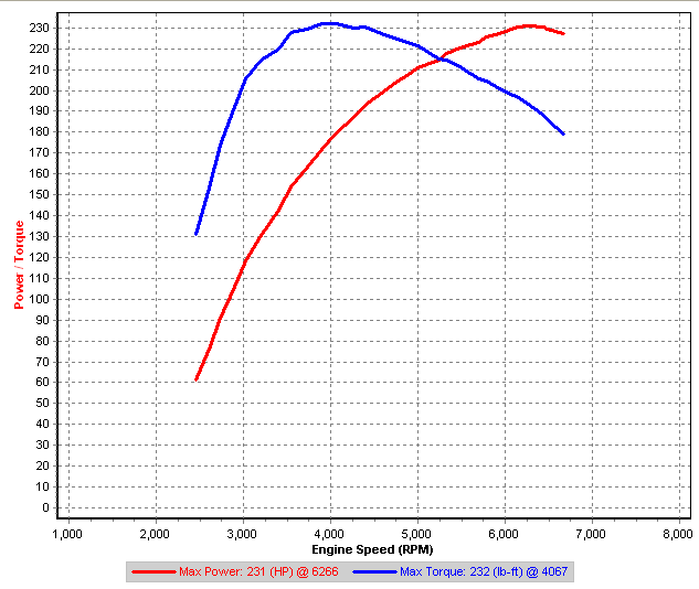

HKS DP installed
v1-16 Dyno results. Boost was pulled over 6000rpm since we ran out of fuel.
- Attachments
- v1-16 3rd gear Dyno @ IAT30.png (10.51 KiB) Viewed 14430 times
- v1-16 3rd gear Dyno @ IAT32
- v1-16 3rd gear Dyno @ IAT32.png (11.23 KiB) Viewed 14489 times
- v1-16 3rd gear Dyno @ IAT35
- v1-16 3rd gear Dyno @ IAT35.png (11.03 KiB) Viewed 14490 times
- v1-16 4rd gear Dyno @ IAT30
- v1-16 4rd gear Dyno @ IAT30.png (10.95 KiB) Viewed 14477 times
