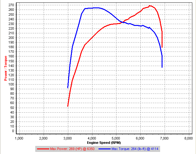

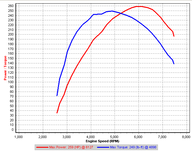

The power is almost the same because after all the mods, stock boost spike at 20psi. The customer wanted me to leave it at and tune for 20psi. Per usual, other stuff was changed like the Intercooler spray and so forth, but a better fuel map The car is very responsive and fuel economic.
Stock
Stock 3rg Gear Dyno.png (11.4 KiB) Viewed 6448 times
V1-2 Road Dyno
v1-2 4th gear road dyno 1.png (11.35 KiB) Viewed 6448 times
