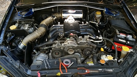

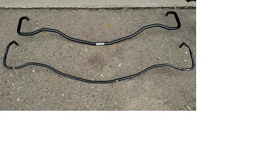

So, its been a few months since ive been able to get back into tuning the BlackBird 3.0R..BlackBird...thats what im calling the 3.0R now..lol...anyways, since i live in the mountains up at 4000ft,theres been alot of winter weather, rain, snow, LOTS of snow. so its hindered the tuning process. Although, in this down time i have gotten a few suspension modifications to the BlackBird. Ive swapped out the rear OEM sway bay(I believe its 15mm) for a Cusco 21mm rear sway bar and Cusco rear sway bar brackets,to reinforce the stock sway bar brackets in the rear. I also replaced the OEM rear end links with WhiteLine Rear Adjustable end links. Im also planning on swapping out the OEM rear differential support for the Beatrush Rear diff support(i have part, just needs to be installed)...Ive also installed a rear 2point Brace(SubFrame brace/Rear Arm Bar), which has really stiffened up the rear end..it sticks to the road now!! Ive got a Bunch of front end suspensions upgrades to come in the next month or so..pics will follow!!

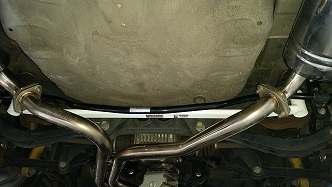

Rear end with 2point rear frame brace
rear end pic.jpg (36.52 KiB) Viewed 37449 times

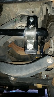

rear sway brackets.jpg (39.48 KiB) Viewed 37449 times

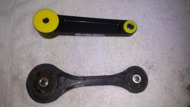

Oem rear sway bar(15mm) Vs Cusco Rear sway bar(21mm)
rear sway bar.jpg (26.65 KiB) Viewed 37449 times

A few more mods comming up for the 3.0R will be...Beatrush rear diiferential support install...Cusco Front sway bar 23mm, Custom front sway bar brack, courtesy of ChrisTurbo, Front Whiteline Adjustable end links, JDM front control arms, Whiteline conrtol arm bushings, Rear anti tramp insert bushings. As well, im adding a mishimoto 10row oil cooler and a termostatic oil plate and 169C Tstat. Then Brake parts to follow..DBA 4000xs series rotors, Ferodo DS2500pads, GrimmSpeed Brake Master cylinder brace, and Kakimoto Kai Stainless Steel Mesh Brake Lines, as well as Motul RBF600 Dot4 racing brake fluid. Ive also gotten rid of my OEM pitch stop brace and replaced it with a KartBoy Pitch Stop Brace & Installed and SPT Heat shield

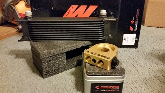

Mishimoto oil cooler & thermostatic oil plate
oil cooler.jpg (41.19 KiB) Viewed 37448 times

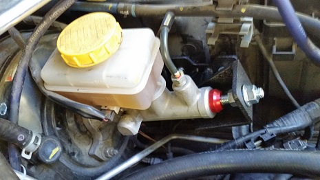

GrimmSpeed Brake Master Cylinder Brace
GS brake master cylinder brace.jpg (62.76 KiB) Viewed 37448 times
