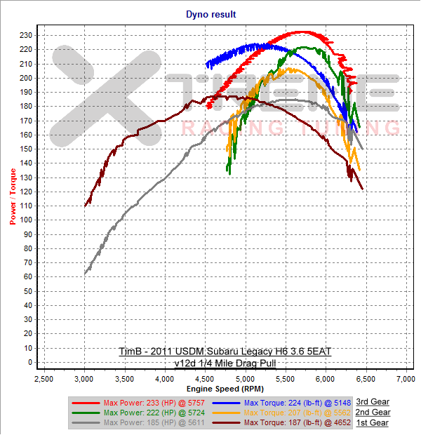

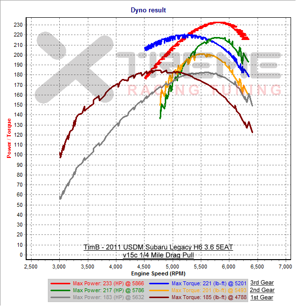

TimB - 2011 USDM Subaru Legacy H6 3.6 5EAT - Tuning
v12d & v15c - 1/4 Mile Drag Pull
v12d Quarter Mile Drag run.png (38.05 KiB) Viewed 18854 times
v15c Quarter Mile Drag run.png (37.63 KiB) Viewed 18854 times
Further testing of more advance 5EAT tuning
XTMP
https://www.facebook.com/groups/SubaruT ... 0952473261
I'm loving this TMP so far. I downshifted to 3rd on the highway earlier and the car was pulling off at 70MPH like a madman. Taking off from a stop is much nicer as well. The pedal response is up a bit more. When I first got my car, the stock throttle is just, blaah. At this point it would be like putting the car in limp mode. I can't imagine how the car would react with a decent jump in power. I really need to get race gas to see, as Ed has been stating. But as he said, he'd be sorry for me because I would just want more and more octane 😂
