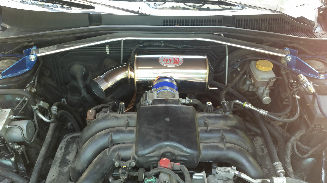

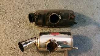

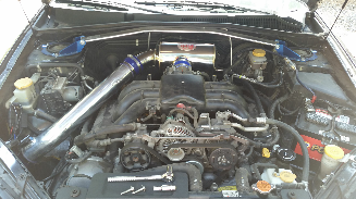

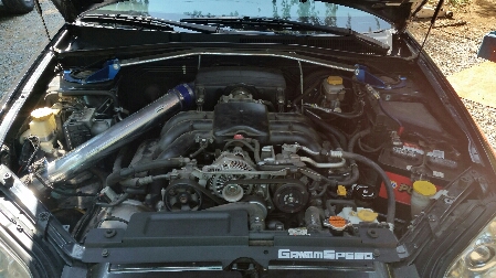

KakiMoto Racing Intake Chamber Install
Heres some before and after pics of the Kakimoto racing Inatke Chamber Installed On The Legacy 3.0R!! Man does she make the needle fly thru the Rpm Range!! First off the Lower Rpm range is MUCH improved! its like she just wants to go even at 1500rpm it just jumps to 3000rpm like nothing then shoots up to 500rpm and slams thru to redline! its like theres 3 power ranges and everytime it reaches the next one it gets more intense and fast!! You can really hear her gasping in the air and sucking the whole way thru..Its quite impressive! Im very Pleased with the upgrade and it looks awsome compared to that black plastic box behind the throttle body!
The Intake system is nearly finished, just waiting for the BMC OTA to arrive, so i can remove CAI filter element and install the BMC OTA! together the BMC OTA & kakimotor racing intake chamber should be an awsome combo for the intake system!! More updated pics to come once the BMC OTA arrives!!

- Before Shot With Just CAI installed
- 2015-09-02 10.36.39.jpg (125.53 KiB) Viewed 39483 times
- Look at The Comparison! I wish you could see the Baffle inside the Kakimoto Inatke Camber!
- 2015-09-02 10.34.12.png (155 KiB) Viewed 39483 times
- Doesnt That Look Beautiful!
- 2015-09-02 10.33.48.png (120.72 KiB) Viewed 39483 times
- Finished!
- 2015-09-02 10.33.21.png (132.38 KiB) Viewed 39483 times
