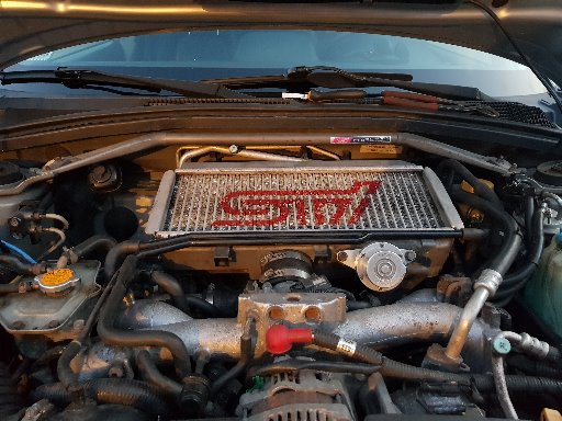

- STI Intercooler with Forge BOV

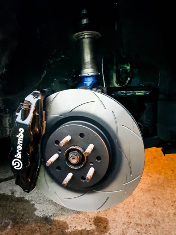

- STI calipers both front and rear, DBA T2 brake discs with CL5+ pads front, DBA Street Series with DS2500 pads rear

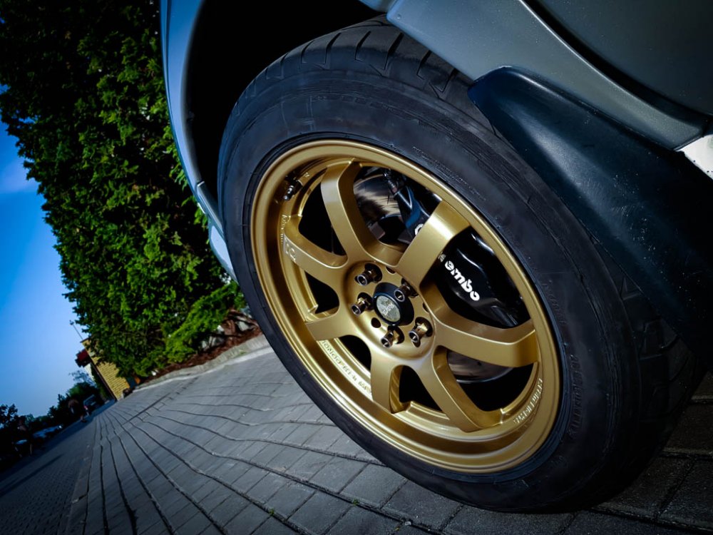

- Rays Gram Lights 57S 17' wheels
STI TMIC.jpg (80.67 KiB) Viewed 11108 times

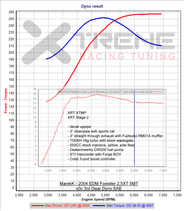

v0a 3rd Gear Dyno
v0c 3rd Gear Dyno SAE.png (84.56 KiB) Viewed 11069 times

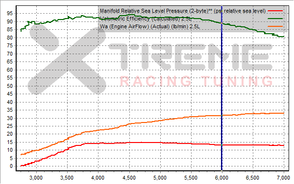

v0c 3rd Gear Dyno Engine Flow Data.png (18.03 KiB) Viewed 11068 times

Ed as always did an amazing job tuning this car. Now it feels like way quicker than it seems from the numbers, as the goal was to create good street car with lots of midrange torque. Congrats to ED for his job! :)
