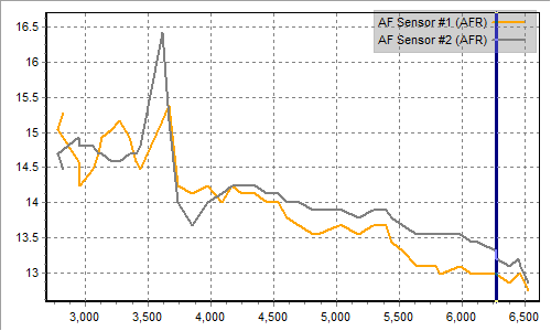

Below is a log review I have done for a customer who is running E85 and have issues. Tuning was done by another tuner. XRT just offers a review.
References:- 065808

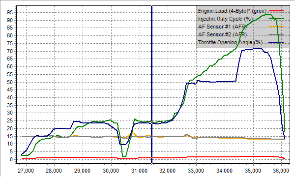

AFR #1 (RH) is telling me that side is lean. I am not sure if both sensors are new. If that is correct, you have either an intake leak in that side or in the exhaust headers.
http://www.xtremeracingtuning.com/forum ... =100&t=548
AFR Readings.png (8.43 KiB) Viewed 23985 times

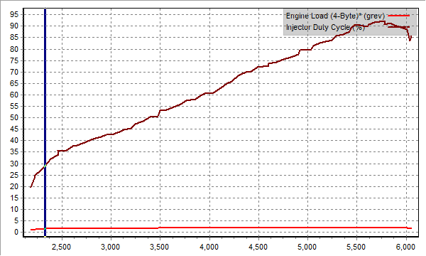

070009
Like I always recommend to E85 users, you should upgrade your injectors or raise the fuel pressure slightly. Injectors should really be never run over 85-90%, especially over 90%.

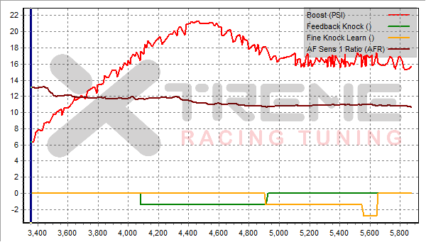

071535

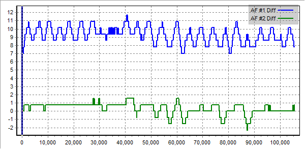

Lovely log for a tuner to zoom in and correct fueling issues. She is lean and in some instances adds quite a bit of fuel to run correctly and efficiently. Those large AFR correction swings you maybe able to feel and because the ignition is kinda low for e85, it means you could feel that lack or power to hesitation more. The car is SUPER SUPER safe in novice terms.

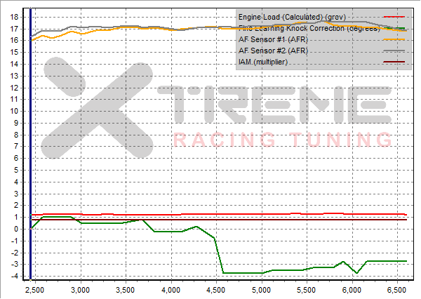

072515
Same as the previous log. If the car use to run great and then issues, well once can say there is an intake leak between (post) MAF and the throttle body. If not could be a fuel pump issue. But this must be based on no issues from before. From the log, the car needs tuning. The operations of the E85 is too lean with kind of low ignition.

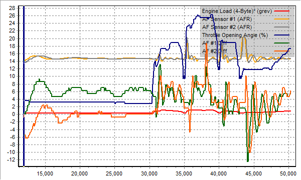

072849
Again, in my humble opinion, E85 should not be run on these cars due to Injector flow limitations. Injectors are being run over 90% and with the current AFR being a little lean, if the car AFR was tuned to be a little more rich, injectors will be run close to 100%. This run was not even at full throttle and full RPM was not used. It would be interested to see your EGT, oil temperature for pulls :) Can you log the oil temps?

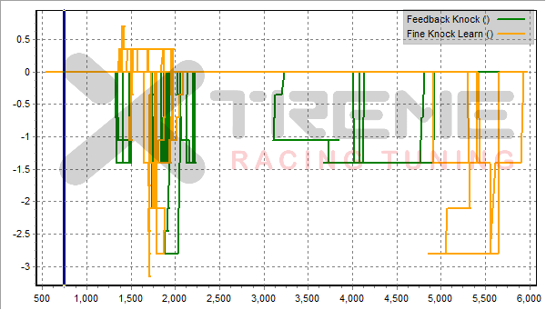

Before tuning, I had my customer sent me a gear pull log. Below is the result from such pull.
In review, we have to determine why the car is running extremely lean. Its possible the MAF is extremely dirty, the MAF is not secured or some clamps are loose post MAF.
