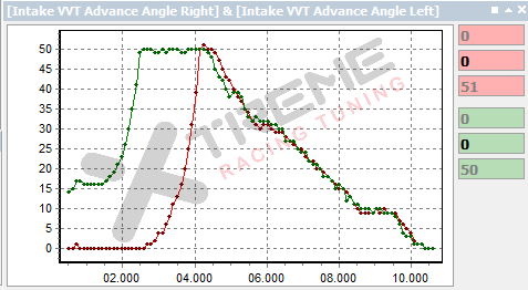

Right AVCS Issues.png (15.08 KiB) Viewed 20503 times

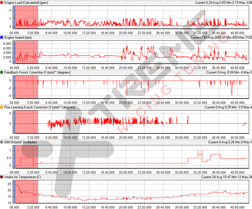

Stock Criticals.png (78.93 KiB) Viewed 20503 times

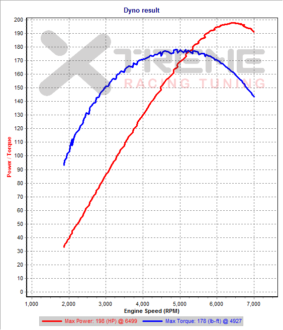

Stock 3rd Dynoes SAE.png (21.49 KiB) Viewed 20282 times

v4 vs Stock - 3rd Gear Dyno SAE
XRT v4 vs Stock - 3rd Gear Dyno SAE.png (33.93 KiB) Viewed 20282 times
