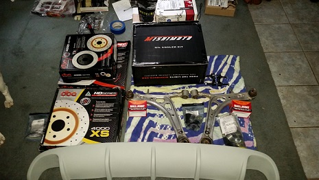

Brake Parts To Be installed as Follows:
-DBA 4000XS Series Rotors
-Ferodo DS2500 Brake pads
-GrimmSpeed Braker Master Cylinder(Already Installed)
-Kakimoto Kai Stainless Steel Mesh Brake Lines
-Motul RBF 600 DOT4 Racing Brake Fluid

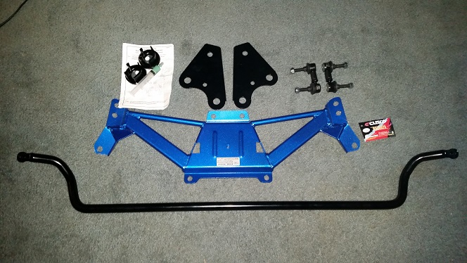

Front Suspension Parts to be installed:
-JDM front control arms
-WhiteLine Control arm Bushings
-New Ball Joints
-Custom front sway bar brackets
-Cusco front sway bar 23mm
-Whiteline front adjustable end links
-Cusco front crossmember power brace
-Cusco Mounting plates
Rear Suspension parts:
-Whiteline anti-tramp diff inserts
-Beatrush rear differential support
-AVO rear power brace

- Parts to be installed!!
- parts!.jpg (68.72 KiB) Viewed 36029 times
- Front Suspension parts
- front suspension parts.jpg (125.58 KiB) Viewed 36029 times

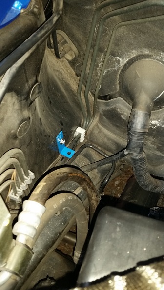

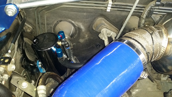

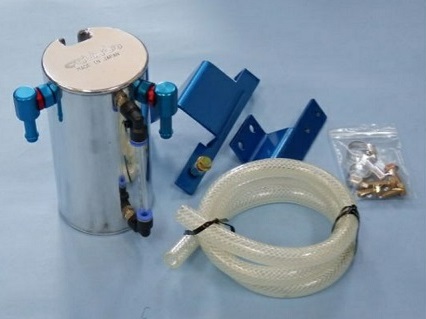

Cusco Oil Catch Can Install
So ive been having a minor issue with pinging, not major, not audiable, but its there on the logs in certain conditions, its primarily due to the crappy gas we have here in the mountains(i use 91, but i swear its 87/89..so call it 88, but it sure acts like its low grade gas..) So i placed an order for this Cusco Catch Can (part# 00B 009 HA), its a universal part, seeing as they dont make a special bracket for the Legacy, like they do for wrx/sti...So the install was rather straight forward, find the Breather port on the driver side vave cover(for legacy 3.0R H6)...the line from the breather heads up to the nipple on the driver side of the Kakimoto intake chamber...After looking around the engine bay for a spot to mount the catch can(I wanted it close to the battery, driver side, thats where my breather port is, but it was too tight to fit it into that area..) I found a huge empty spot near rear back by the firewall on the passenger side, mounted a supplied cusco bracket... Then i just plumbed the catch can inline between the breather port and the chamber nipple..After getting a longer than supplied length of hose and a few more hose clamps, it was all hooked up and ready to go! took it for a test drive/test logging...ed took a look and said it was "Clean!"...Im impressed and excited!
Mishimoto Oil cooler install comming soon...

- Cusco Oil Catch Can Kit 00B 009 HA
- cusco catch can.jpg (33.92 KiB) Viewed 35947 times
- Catch Can Mounting Bracket
- catch can mounting bracket.jpg (105.75 KiB) Viewed 35947 times

- Cusco Catch Can Installed
- Catch can install finish.jpg (117.33 KiB) Viewed 35947 times
