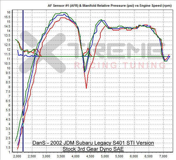

It performs fantastic with the v6 rom. Dont know if it is true but I did not feel the hesitation at first turbo. Also I think second was much faster. It rev fast with strong power. So funny
There was lots of people, cars and police out. Think it is the warm weather, so I drove like granny I think but try to my best.
In all files car worked smooth and with plenty power, however, 2 times I got fuelcut or boost cut, dont know but my knee hurts now. You know bang and body goes forward. It happend first time on 4th gear in a hill. It is on file.
Second time it also happend in 4th gear after wot from 3rd, slightly downhill or straight road, also on file.
So car goes like mad when WOT. If we can sort out the boost cut (saw it was almost 18psi) it is great and I cannot wait to take father out for a spinn
Temp around 20-21 degree C
50-70 roads and also 110 road
Thanks Edward for great rom
