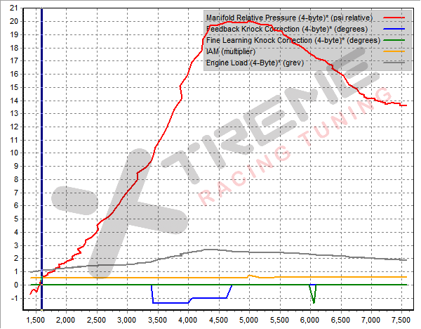

Stock Dyno vs Boost Curve - 2015-03-28.png (32.56 KiB) Viewed 10556 times

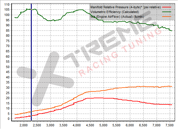

Stock Dyno Data Info #6 - 2015-03-28.png (32.5 KiB) Viewed 10556 times

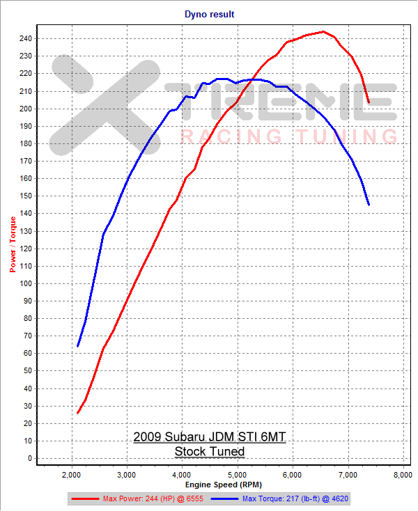

Stock 3rd Gear Dyno SAE sm=1 tm=120.xml.png (30.91 KiB) Viewed 10466 times

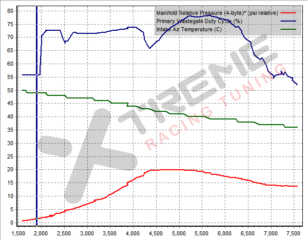

Stock Dyno Data Info #1 - 2015-03-28.png (45.77 KiB) Viewed 10556 times

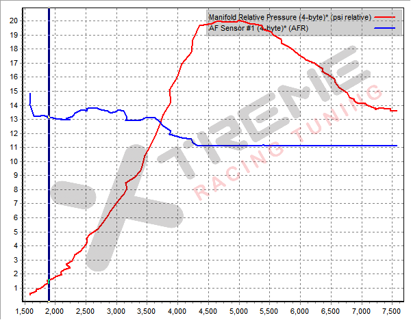

Stock Dyno Data Info #2 - 2015-03-28.png (44.12 KiB) Viewed 10556 times

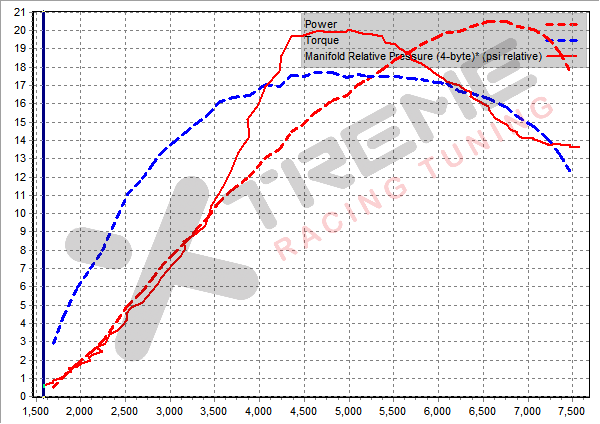

Stock Dyno Data Info #3 - 2015-03-28.png (49.55 KiB) Viewed 10556 times
