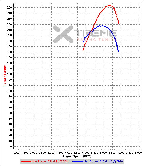

v27c 4th gear Dyno IAT=33C.png (14.78 KiB) Viewed 30141 times

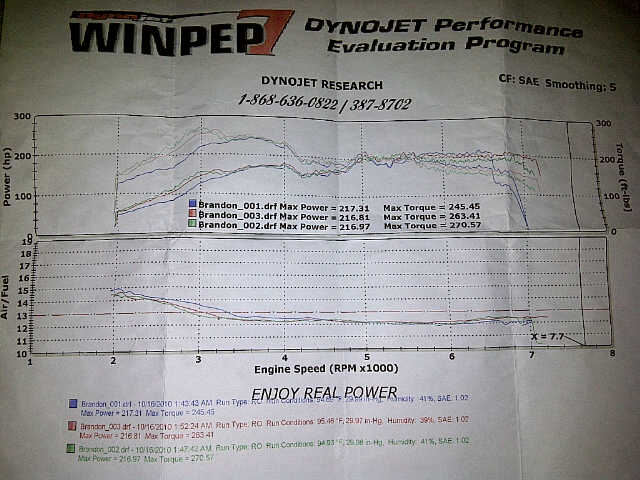

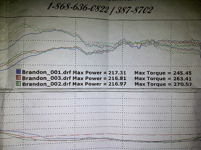

Early Dyno sessions
Issues noted:
BOV, Wastegate, etc
