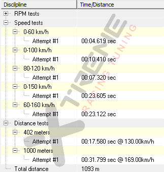

v5 Drag Info
v5 Drags #1.png (22.27 KiB) Viewed 35862 times
v5 Drags #2.png (20.24 KiB) Viewed 35862 times
