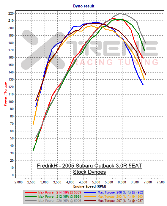

Stock Dyno
Environmental Data
Code: Select all
Time (CET) Temp. 	Windchill   Dew Point 	Humidity 	Pressure 	Wind Dir 	Wind Speed
8:20 PM 	0.0 °C 	-2.5 °C 	-1.0 °C 	  93% 	      987 hPa 	SSW 	     7.4 km/h / 2.1 m/s
Stock 2nd Gear Dyno SAE.png (37.93 KiB) Viewed 12730 times

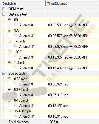

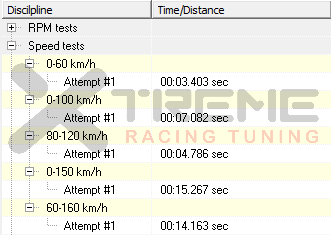

Drag info - 2016-01-31
Code: Select all
12:00 AM 	1 °C  	    - 	   -2 °C 	    74% 	     972 hPa 	 SW 	      14.4 km/h
12:20 AM 	1.0 °C 	-3.1 °C 	-2.0 °C 	  81% 	     972 hPa 	 SW 	      14.8 km/h / 4.1 m/s
Stock Drag pull data.png (20.68 KiB) Viewed 12693 times
Stock Drag pull data #1.png (6.69 KiB) Viewed 12693 times

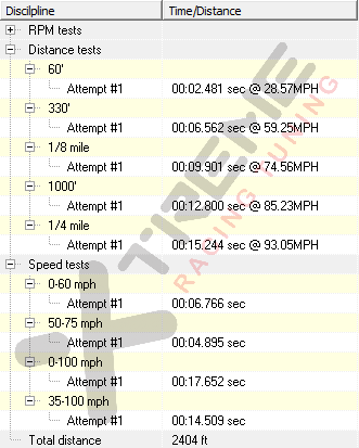

v1 Stats
Environmental Data:
Code: Select all
6:20 PM 	-3.0 °C 	-8.4 °C 	-6.0 °C 	80% 		990 hPa 	NW 			16.7 km/h / 4.6 m/s
6:50 PM 	-3.0 °C 	-7.6 °C 	-6.0 °C 	80% 		990 hPa 	NW 			13.0 km/h / 3.6 m/s
Drag-Stats #1.png (20.82 KiB) Viewed 12718 times
Drag-Stats #2.png (7.55 KiB) Viewed 12718 times

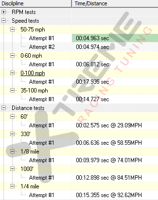

v3 Drag Info
Code: Select all
12:50 AM 	1.0 °C 	-2.4 °C 	-2.0 °C 	  81% 	     972 hPa 	 SSW         11.1 km/h / 3.1 m/s
Drag Info.png (25.85 KiB) Viewed 12692 times
Drag Info #1.png (10.39 KiB) Viewed 12692 times

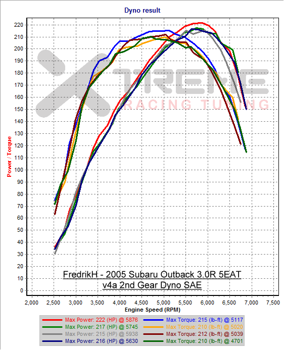

v4a - Dyno Information
Code: Select all
Time (CET) Temp. 	Windchill 	Dew Point 	Humidity 	Pressure 	Wind Dir 	Wind Speed 	       Conditions
8:20 AM 	-8.0 °C 	-11.9 °C 	-10.0 °C 	86% 	     988 hPa 	 SSW 	     7.4 km/h / 2.1 m/s	Clear
8:50 AM 	-8.0 °C 	-11.0 °C 	-10.0 °C 	86% 	     988 hPa 	 South 	   5.6 km/h / 1.5 m/s	Clear
v4a 2nd Gear Dyno SAE.png (40.68 KiB) Viewed 12675 times
