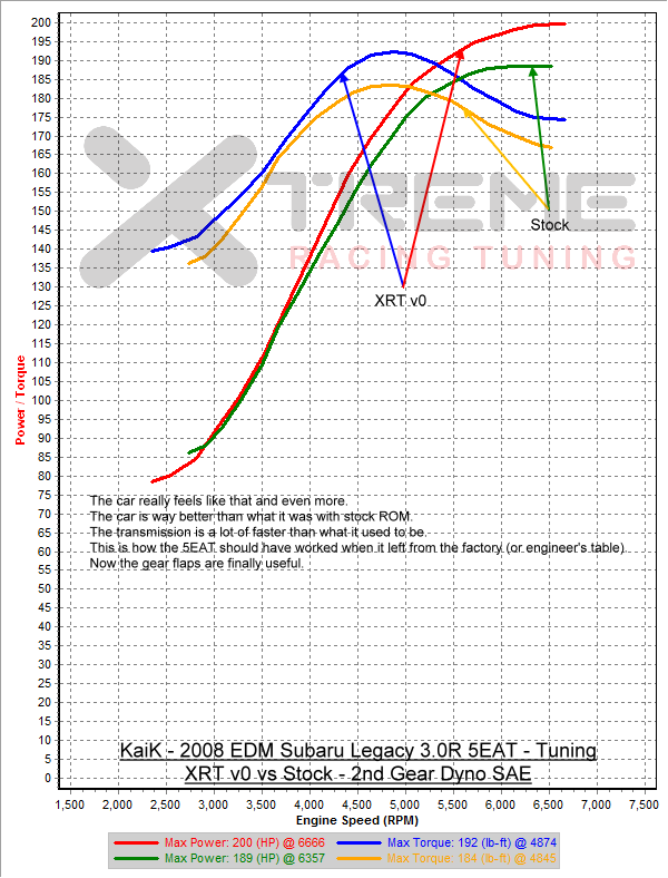

V0 Tuning feedback
v0 vs Stock - 2nd Gear Dyno SAE.png (65.12 KiB) Viewed 7374 times
