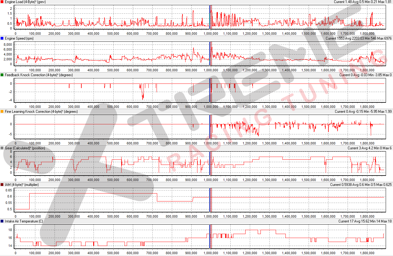

Stock critical data.png (154.94 KiB) Viewed 9230 times

V0 log attached.
Car has much more pulling power from down low now, much easier to get started.
Pete French
v1 Feedback
The car is way faster, more responsive and easier to drive. Don't know if there is any improvement in petrol consumption yet, I am having too much fun burying my foot into the throttle.
Bloody fantastic!
