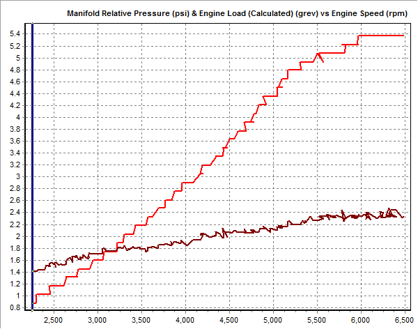

Stock_Based_Map boost_vs_EL
Stock_Based_Map boost_vs_EL.png (11.13 KiB) Viewed 10931 times

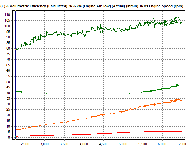

Stock_Based_Map IAT_vs_VE_vs_Wa_vs_boost
Stock_Based_Map IAT_vs_VE_vs_Wa_vs_boost.png (12.44 KiB) Viewed 10931 times

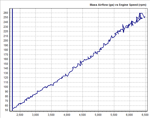

Stock_Based_Map MAF
Stock_Based_Map MAF
Stock_Based_Map MAF.png (11.07 KiB) Viewed 10931 times

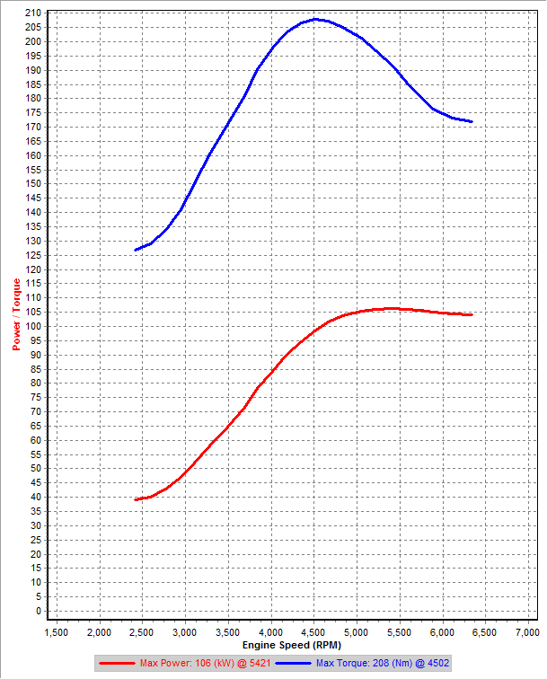

Matt  2nd Gear Dyno SAE sm=2 tm=150 wkw smaller tyres
Matt 2nd Gear Dyno SAE sm=2 tm=150 wkw smaller tyres.png (19.27 KiB) Viewed 10931 times

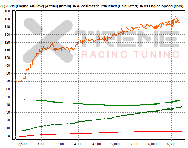

XRT v0a Stats
Max engine flow is around 28-29lb/min. This most likely is due to the exhaust and or intake system being very restrictive.
Raptor Headers are currently in transit.
XRT_v0a 2nd Gear Pull IAT_vs_VE_vs_Wa_vs_boost
XRT_v0a 2nd Gear Pull IAT_vs_VE_vs_Wa_vs_boost.png (19.17 KiB) Viewed 10929 times
