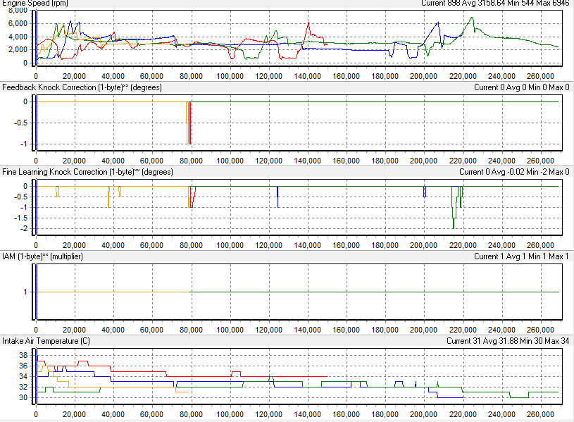

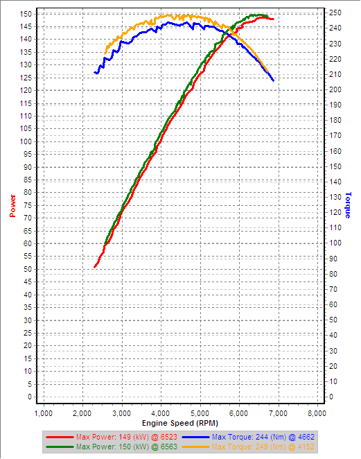

Finally used up the tank and refilled with Premium unleaded and did some logging.
There was a difference in the logs and the bummometer. Torque was definitely lacking in 5th and 6th. So as I am running the tank down. Edward will modify the tune so I can use as my "Premium" rom (V7a). I can load this up for any trips away where there is no 98 available. Even though the main rom we are working on will still be safe for Premium this one will be optimised for it.
When this is done I will refill with the 98 and we can finalise the main rom.
v7b stats
v7b-premium stats
v7b-premium stats.png (20.8 KiB) Viewed 20793 times

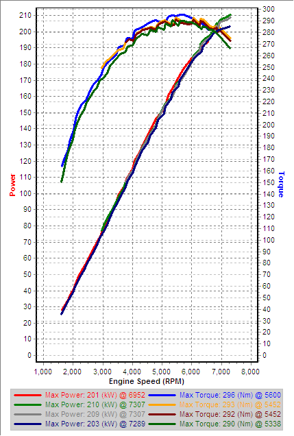

Exhaust Mod
v10 2nd vs 3rd Gear Dyno.png (19.98 KiB) Viewed 20686 times

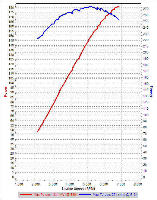

Updated Gear Ratio
Headers installed and tuned
v23 3rd Gear Dyno IAT=33C - Tune with headers.png (17.21 KiB) Viewed 20678 times

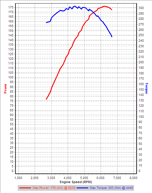

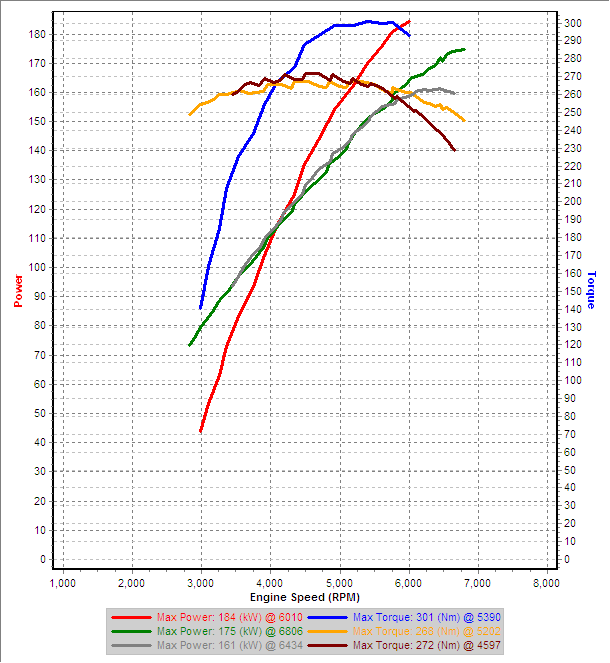

Prelim Results on SC
SCv0 IAT=72C vs v27.png (21.78 KiB) Viewed 20595 times

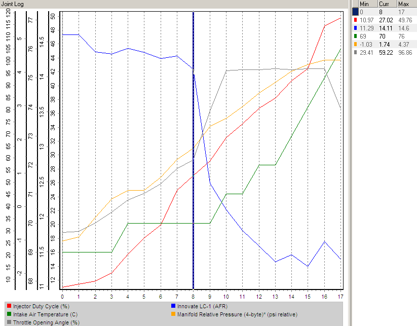

Not a full 3rd Gear pull. Throttle went from 35 to 95% around 4400+rpm
SCv0 - Critical Stats on semi 3rd gear pull.png (25.59 KiB) Viewed 20592 times

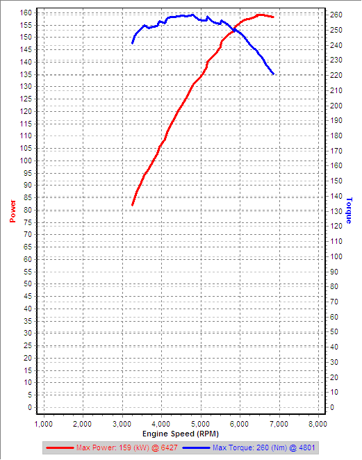

SCv1
scv1 3rd Gear Dyno IAT=62-80C comparisons.png (32.04 KiB) Viewed 20585 times
