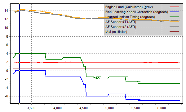

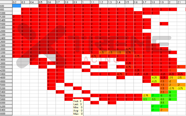

Currents logs from AMR tuned
Tuned by AMR - Critical Ignition Related issues.png (12.44 KiB) Viewed 17390 times

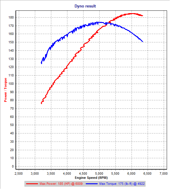

Tuned by AMR - 2nd Gear Dyno SAE.png (18.09 KiB) Viewed 16317 times
Pinging Issues.png (45.18 KiB) Viewed 17392 times

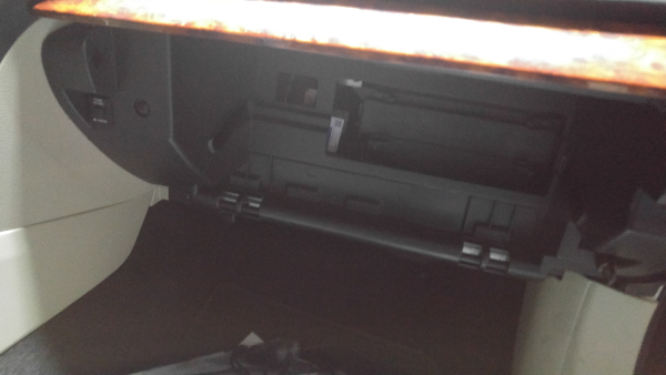

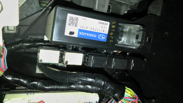

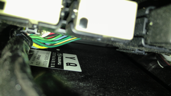

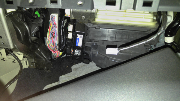

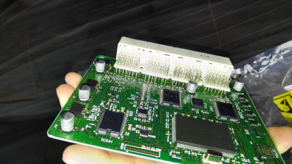

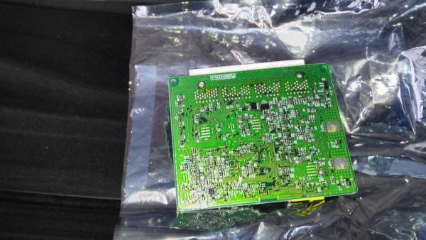

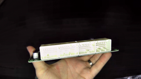

Fast forward a few days and after some debugging from Tactrix it turns out we could neither read nor write as it was locked in both regards. I called the shop and requested a remote unlock which they refused to do. The options were to send them my ECU so they could flash me back to stock, or drive the 7 hours in order to unlock it. Neither were acceptable because they offer remote tuning options on their website and I didn't want to tear my car apart just to put the stock tune back on, hope they fully re-flashed it back so it was unlocked, and have to wipe it and put XRT tune
So after a week of talking with Tactrix and XRT, I decided I was going to remove the ECU and ship to Tactrix in California where they would not only unlock my ecu, they would upload XRT. Here are the pictures of me taking the ECU out. (In a 5th Gen legacy they are located behind the glove box, not under the passenger foot well like in many other Subarus.

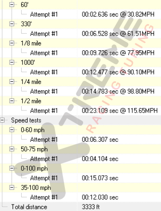

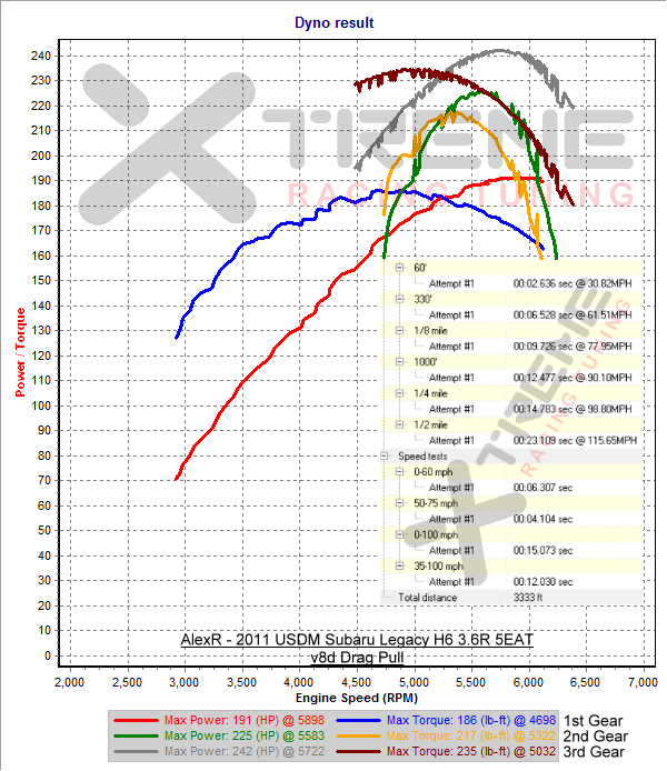

30-80Mph
v8d 1/2 Mile data
v8d half Mile Time.png (77.57 KiB) Viewed 15645 times
Power Drag Pull.png (94.63 KiB) Viewed 15638 times
